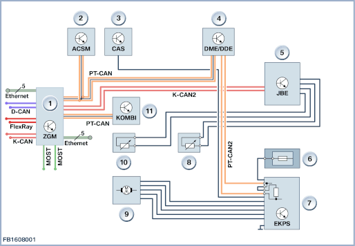

Example of functional networking F01
Item Explanation Item Explanation
1 Central gateway module (ZGM) 2 Crash Safety Module (ACSM)
3 Car Access System (CAS) 4 DME (Digital Engine Electronics) or DDE (Digital Diesel Electronics)
5 Junction Box Electronics (JBE) 6 Electric fuel pump fuse
7 Electronic fuel pump control module (EKPS) 8 Fuel level sensor
9 Electric fuel pump 10 Fuel level sensor
11 Instrument panel (KOMBI)
