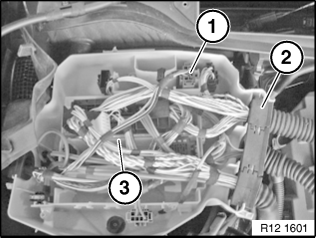

It is absolutely essential to read out the fault memory with the MoDiC or the BMW DIS and to create a fault memory printout.
Switch off ignition.
Unlock fasteners (1) from below and slide upwards approx. 10 mm.
Unlock locks (2) in direction of arrow.
Remove cover (3).
Unlock plug (1) and remove.
Release grommet (2) from electronics box.
Installation:
Make sure grommet (2) is correctly seated in housing (watertightness).
Unlock control unit (3) and raise slightly.
Unlock plugs (1) using slide in direction of arrow and remove.
Remove control unit (2).
